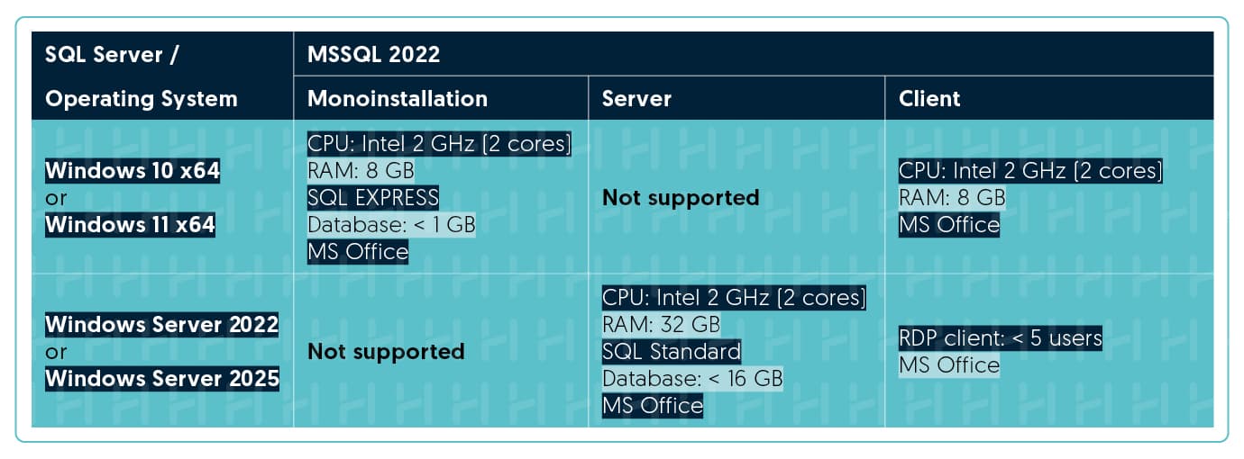

This section contains the hardware and software requirements for computers on which Helios Inuvio will run.
These configurations are the basic recommendation for installing and running Microsoft SQL products and Helios Inuvio. The requirements are only provided with respect to the operating system, MSSQL database server and Helios Inuvio. Other applications and services running on the station or server (besides MS Office), which could further increase the HW requirements, have not been considered. The size of the Helios Inuvio database(s) have also not been considered – this shall be evaluated independently and the HW options need to be adjusted accordingly.
Overview of MS SQL and Windows versions
Bit version of Windows
Due to changes announced by Microsoft concerning MS SQL 2016 products (and probably also future versions), the development of 32bit versions of SQL Server has been terminated.
It is necessary to switch to Windows 64bit architecture wherever MS SQL 2016 will be installed. This change applies to all editions of MS SQL 2016 including Express edition
Current Windows server products already exist only in 64bit form, the change thus concerns desktop operation systems and solutions such as Helios Inuvio MONOINSTALLATION.
MONOINSTALLATION
The Helios Inuvio information and economic system is installed and operated on a single computer. The database as well as the applications are run on the same PC, in the form of a local access.
Note: Under the assumption that the size of the database(s) > 1GB, we recommend discussing the configuration with Asseco Solutions, a.s.
SERVER
The Helios Inuvio information and economic system have been installed on a reserved SERVER. The SERVER manages the database and shares application within the network for CLIENTS. Under these conditions, the SERVER can also be the CLIENT, via remote desktop (RDP).
Note: Choosing the number and performance of processors primarily depends on the number of users. The size of RAM depends on the number and size of the database. With a number of users > 10 and/or expected database size > 5 GB, we recommend discussing the configuration with Asseco Solutions, a.s.
CLIENT
CLIENT computer of the Helios Inuvio system within the computer network, where the SERVER has been installed. CLIENT runs the application from the shared folder and connects to the database on the SERVER via network access (LAN, WAN). Under these conditions, the CLIENT can operate on the SERVER directly, via remote desktop (RDP).
Note: Under the assumption that the size of the database(s) > 4GB, we recommend discussing the configuration with Asseco Solutions, a.s.

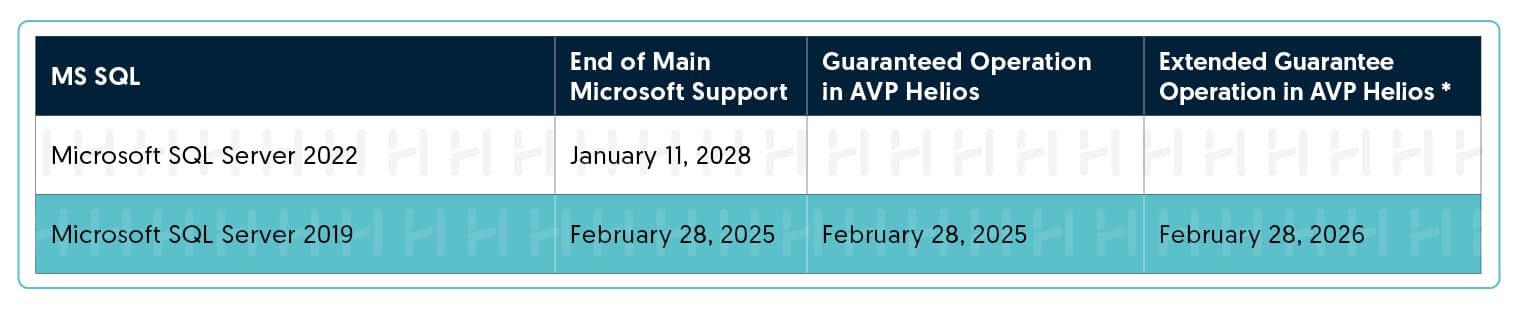

This section contains information about the dates when support for certain Microsoft software products will be terminated (i.e., the column "Termination of primary Microsoft support"), dates when this is taken into account by our company (i.e., the column "Termination of Asseco Solutions") and last but not least information about the impact of this fact on the Helios Inuvio IOS iNuvio product.
Due to the fact that, as of the date of termination of primary Microsoft support, Microsoft will no longer guarantee compatibility with third-party products for the given product (i.e., it is no longer a "Supported Environment"), we have no other option than to continue developing Helios Inuvio (i.e., to develop further updates and upgrades) only within the Supported Environment. In other words, this means that new versions of APV Helios released after the end of Microsoft support, or specifically after the end of support by Asseco Solutions, have been developed for operation exclusively in the Supported Environment.
Note that if you will operate Helios Inuvio in an unsupported environment and simultaneously download a new version of Helios Inuvio released after the appropriate date of termination of support by Asseco Solutions, our company will no longer be responsible for any potential defects of such a Helios Inuvio installation. That is why we recommend that all our customers, always at the latest by the date of termination of support by Asseco Solutions specified below, use the latest software products supported by Microsoft.
Please visit the appropriate Microsoft website to obtain the latest information regarding Microsoft's supported products.
* Extended warranty APV Helios is a paid service for customers using the APV Helios information system who, for various reasons, can not or do not want to upgrade Microsoft software with the main support in which APV Helios is operated.
This service will enable the Helios APV to operate in an unsupported environment, with full APV Helios manufacturer warranty.
